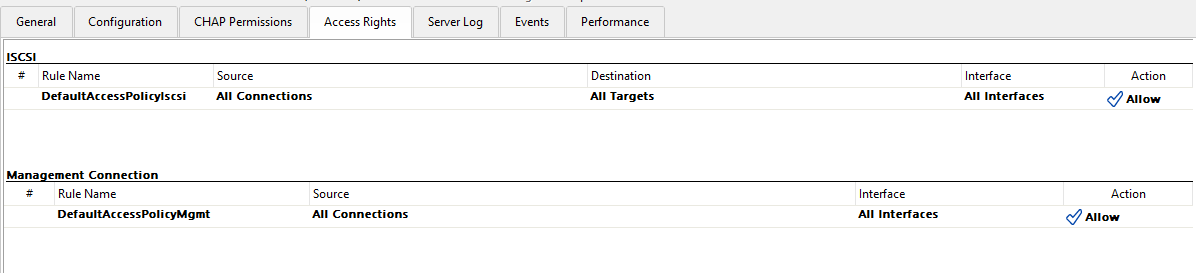

StarWind enables users to set access restrictions for initiators.
There are two sections in Access Rights: ISCSI and Management Connection.
  • ISCSI - used to restrict access for initiators to connect to the targets.
  • Management Connection - used to restrict access to connect to StarWind service.
Note: A Default Access Policy will be applied to all newly created targets. Individual access rights can also be set.

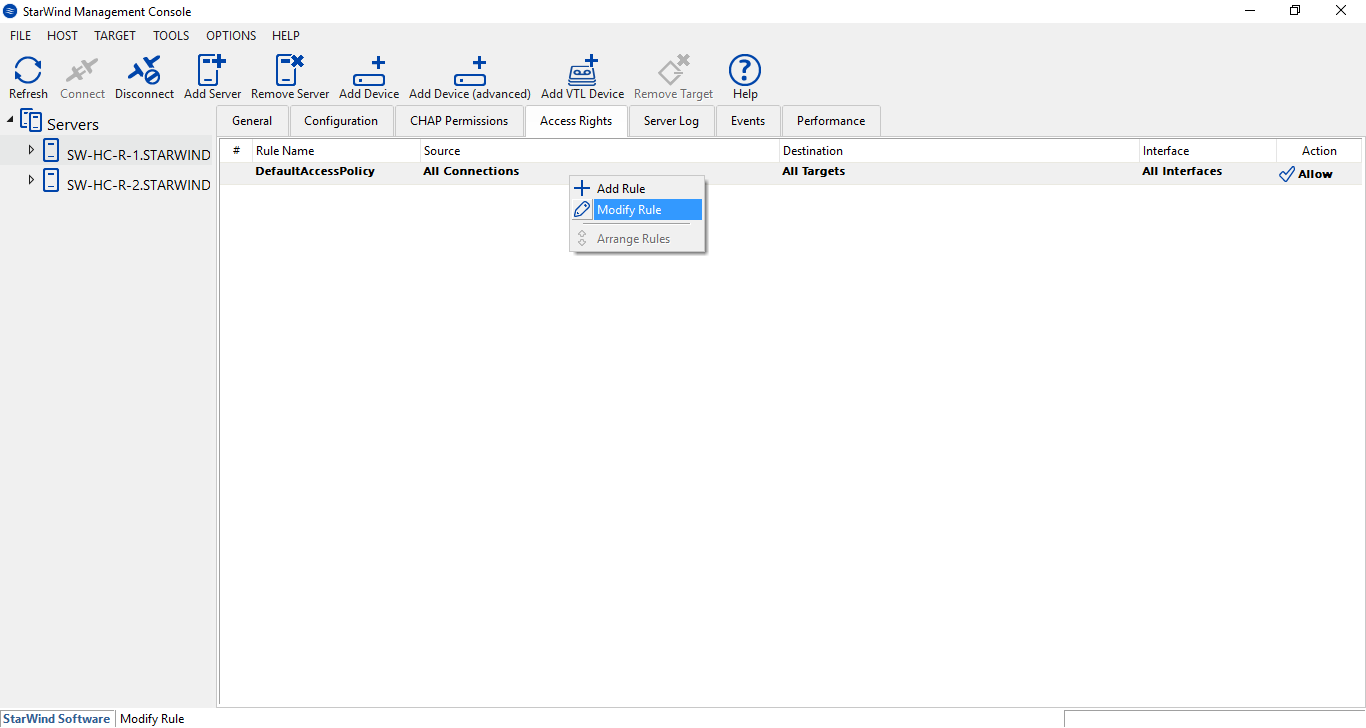

To add a new access rule:
1. Right-click the target and select Add Rule.
2. Enter a rule name and click Add to fill out the Source field.
3. You are prompted to specify either an IP address, DNS name or unique IQN. Select the appropriate option, specify the required data and click OK.
Note: Use Modify to change the source settings and Remove to delete specified connections, targets and interfaces.
4. If needed, select the Set to Allow check box.
5. Go to the Destination tab, click Add and select a target name from the drop-down target list. Click OK.
6. Select the Interface tab and click Add. Then, select an interface from the drop-down list. Click OK.
7. Click OK to add a new access rule.
To modify an existing rule:
1. Right-click the access rule you want to change and select Modify Rule.
2. Click OK to confirm the changes.
To remove an access rule:
1. Right-click the access rule you want to delete and select Remove Rule.
2. Click Yes to confirm the deletion.
